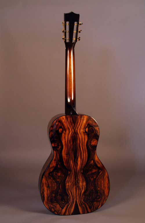

Here are some examples from my collection
1st Macassar Ebony
PostPosted: Mon Jun 25, 2007 11:45 am
1st Macassar Ebony
I find that Mac has nice browns and darks

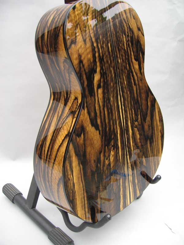

The next one is Black and White ebony I got from the zootman. I would love it if he could tell me more about this wood. The light are much lighter than mac ebony and are a bit blond in color
